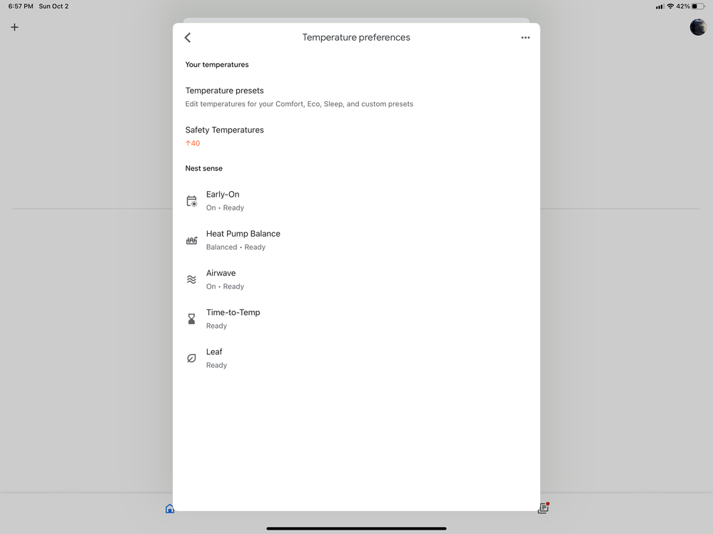

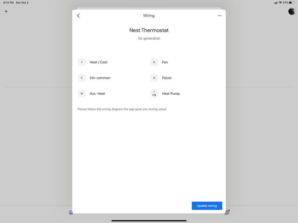

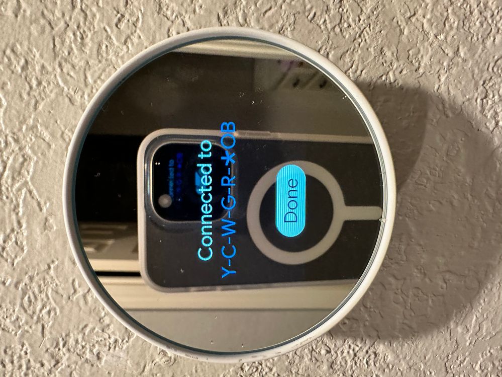

Hello! We recently moved into a house with a York heat pump (model YHJD30S41S4A) and existing Nest Thermostat. We did a factory reset of the thermostat to reassign the account and Wi-Fi. Great!
However, while heat produces heat and cool produces cool, the fan runs constantly… ALWAYS. The fan doesn’t shutoff, even with the Nest set to ‘Off’ and without a schedule set for the fan.
The previous owner claims it all worked perfectly for them (just weeks ago). Any ideas…?

The green wire is for the fan.
You can try to remove G wire it at the nest and turn system back on see if fan still runs without the G wire connected. If it still runs go to the air handler and check if any wires are touching the G wire where they connect to the terminal strip screws.
If everything looks normal at the system end take pics of the control board etc.
