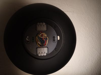

Ok.. here are pics and I will try what you posted and jeep you posted.. thanks. I put up 3 pics. If they did not go through, I'll type out model information to you..
With that test, We know that the thermostat wires are connected and working.  The problem you are having is two for, 1. Your thermostat is not configured properly. You have a Forced Air system with Gas fuel.  Now the term air handler refers to a forced air system.  There is a return duct and a supply duct and a blower fan that circulates the air.

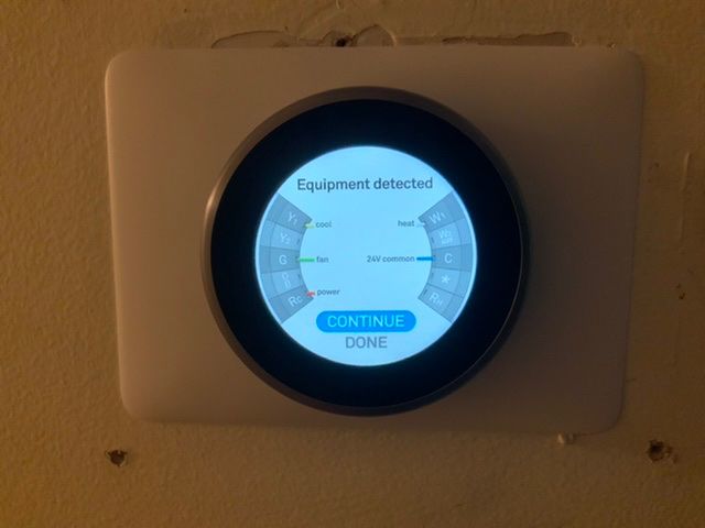

You need to make the changes on the Thermostat itself.  Go to Menu, select, rotate ring to equipment, select, the thermostat will show you a picture of the backplate with the wires it detects. Your will look different since this picture is a 3rd generation thermostat back plate. Just Make sure all 5 wires show up as detected
Then select CONTINUE, The thermostat now shows your system and you should see HEATING COOLING and FAN, press CONTINUE,  now it  switches to equipment settings, rotate ring to HEAT TYPE, select, rotate ring to GAS select, then it switches to TYPE, rotate ring the FORCED AIR and select,  then select DONE.  Now, let’s test it.
Select EQUIPMENT again, once again the backplate picture show up, shows the wires detected.  Select CONTINUE, and now select TEST, and test the HEAT to test.

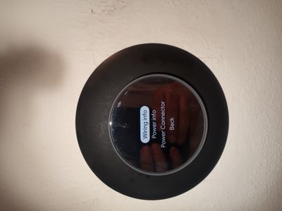

rtrev64
This is all I see when I click on equipment,
It says white (W) and red (R) undetected..
I do not know that first generation nest thermostat so I don’t know if it’s saying that the blue wires are not detected and the gray one is not in use, or watt. On the third generation and software what it does is show you which wires are connected in their colors and it learned the colors of the wires technically when we did the online configuration tool. That is neither here nor there, at this point I really wish you can do a factory reset on your thermostat, and start over.
The wires of your old thermostat and their colors are as follows
R is red
Y is Yellow
C is Blue
G is green
W is White.
when you go through the set up again,  choose forced air system, gas heat.
