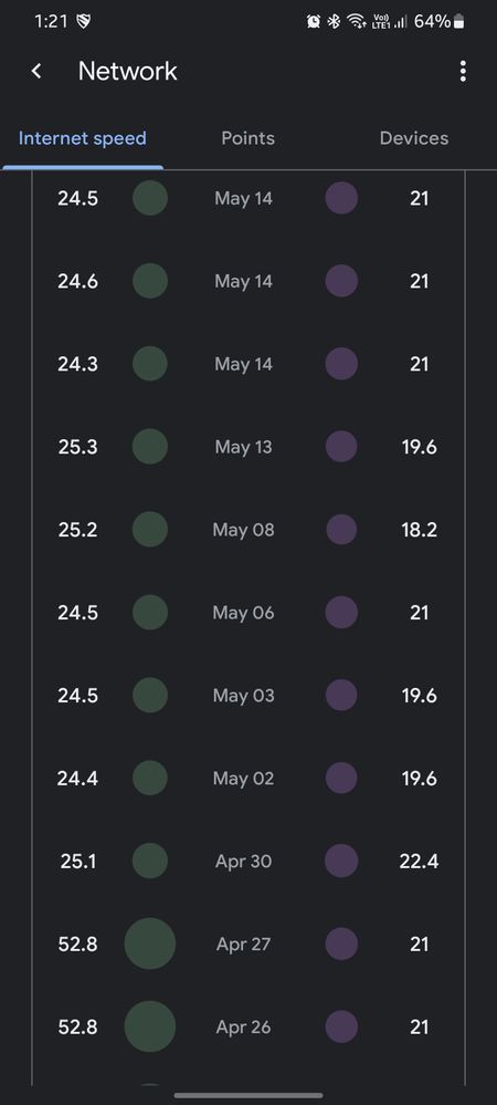

1 router + 3 points setup. Around 22 connected devices. All QoS settings are off. Everything else is on default.
All good until just over three weeks ago.
Firstly I had the known 'wifi point offline' issue. I eventually managed to re-add after a full Factory Reset on the network.
Then I churned my NBN provider to a 100/40 plan but found I was only getting ~48/26. A call to the provider (and a check on the modem) showed I'm getting around 90/30 to the modem.
Factory reset everything including the supplied provided router/modem. Its inbuilt wifi gave me 80/27 before I set it back to Bridge mode and allowed the Google Router to handle the connection.
Setting up the Google Router gives me (via the Home app) a download speed of 80/27 until I start connecting the points. Wifi connection is equally good.
1 point setup - I still see good speeds of ~78/27 however after a few hours, the Home app inbuilt speed test drops to reporting 49/26 although I haven't touched anything to do with the routers connection to the modem 😐
Speeds over wifi are still sitting at ~78/27?! Weird.
2 points - speeds drop across the Mesh to max ~ 46/26, but upload varies significantly (have checked for unexpected traffic).
3 points - same experience.
Noted firmware 14150.43.80 has now updated to .81. but this doesn't seem to have changed anything.
I removed 2 points to go back to just the router and one point, and things improved. Wifi speeds were back to 78/27 (though the Router continued to report 49/26?!).
Left for a day. All ok.
So I added a point again today, and everything has gone south. I removed it again, and download speeds are still slow, with varying uploads (sometimes 26, then 9, then less, then 26 again).
So am now a bit stuck. My best hope right now I thinkg is to do another complete reset and go back to a one point setup, but this doesn't give me enough coverage and defeats the point of having Mesh in the first place.
Does anyone have any good ideas before I look to other hardware options? What are your experiences with 14150.43.8*?
Thanks 🙂

I can further confirm this is not a QoS issue because the internet speed reported by Google  nest will be divided between multiple devices. For example. My internet speed is 250Mbps down, but google nest reports speed as 50Mbps, upon testing simultaneously running speed test on 2 devices at the same time, both peaked at 25Mbps . This enrages me further because google nest is truly throttling speed that completely does not make sense, which leads me to believe this is a software bug with still no ownership from google to fix.

Same situation here. I found the issue in early April and raised a ticket to Google, but the support keep saying that it's a firmware issue (14150.43.80) without any solution.

We've got a main and a single point set up, the hardware is on software version14150.43.81, and we've been having brutally slow internet speeds nearly daily (until a power cycle) for months now. What's the latest?

I’ve ran into similar issues. I have 2 nest wifi routers, both on the running latest 81 firmware.
My ISP is Sunrise from Switzerland and I have a symmetrical fiber connection 200/200.
Initially, my speedtest results were 35 down and 200 up, both reproduced with factory resetting individual routers, swapping all the cables and checking all the ports. Since I couldn’t believe that the issue can be with Google I called the ISP, but then I couldn’t reproduce the results by connecting directly to ISP’s router.
Then I literally connected both of the nest routers to ISP router, created two different “homes” and started changing every single setting to see if it changes anything.
In the end, the magic sequence that worked for me was to first change the DNS resolution to ISP, then change it manually to Google’s servers and it didn’t break.
I couldn’t believe it - it doesn’t make any sense, how can DNS be related to this issue? I always thought that DNS can only influence the address resolution and not the speed of the internet. To make it even more interesting, changing DNS on an end device wouldn’t fix the issue, so at least that made sense. Finally - if I run a speedtest using google home embedded tool I still get the same 35 down and 200up.
Anyways, I’m not touching it until it breaks next time…

Good news!
Got software update 14150.376.32 today and the speed issue is fixed!
Pretty light on any insight in the changelog, but if the issue is fixed then great.
