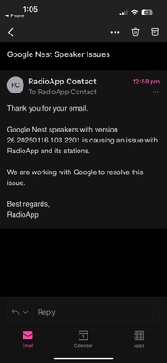

** UPDATE **
This is a Google issue ... probably a bug in a recent firmware upgrade that you have no control over.
If you are on firmware level 26.20250116.103.2201 you will probably have the problem.
It is a worldwide issue for Nest Hub devices. Google are aware and some users in the UK have recently reported their problem has been fixed. Hopefully just a matter of time before they roll the fix out to us in Australia ... keep checking.

the problem is with Google. Radio App is the app used by a lot of stations and i contacted them.  They said they are working with Google to fix it. It's a world wide outage and only affects certain models

The issue is with google- it's affected radio app with latest update for certain models. Radioapp said they are working with Google to fix it

I contacted Audacy and was emailed this as  a solution:
Thank you for your patience as we investigated this issue further, Google has acknowledged that there is an issue on their end that is impacting some listeners' ability to play i!ludac~ and other radio stations on their Google smart
speakers, including on Google Nest Hub, Google is currently working on a fix for this issue. We may also suggest submitting a ticket to Google Support if you have any other questions related to this specific issue, and to receive
updates from Google once a fix is available.
To submit a ticket to Google Support:
• Click here: b!!ps://su11.11.ort.gQQgle.com/aQQglenest/qethel11..
• Under 'Please select your product family:', select Google Home from the drop-down menu.
• Under 'Tell us what we can help with:' include a few words, such as 'Google Home not playing Au~ stations', or 'can't play radio stations on Google speaker'.
• Under 'Choose the best description of this issue:', select 'Using radio' or 'Play music via Home', You may opt to include your device's serial number during this step. Click 'Next step',
• You may bypass Step 2 (Resources) by clicking 'Next step'.
• Under Step 3 (Contact options), you may select the contact method by which Google may reach you about updates related to this issue,
Thank you again for your patience as Google works to resolve this issue.

The issue is with an update from Google that has affected radio app.  Have been told by radioapp they are working with Google to fix it.
