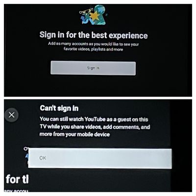

I figured this would stop I logged in but when I tried to log in I received this error message:
Basically it says in Swedish that I can't log in to this TV but that I can still watch as a guest.

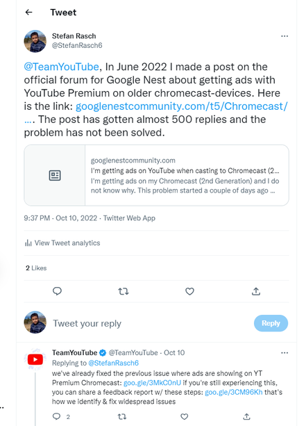

BIG UPDATE: YouTube is now claiming on my post about this on Twitter that this issue has been solved. But from what I see it hasn't because alot of YouTube-users are still commenting on this post and showing photos which clearly shows this is still a problem.
Link to my post on Twitter: https://twitter.com/StefanRasch6/status/1579556765171339264

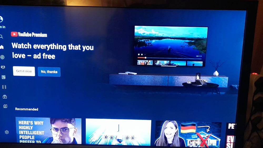

The YouTube app on Chromecast nags the user at start-up to log in, then prevents logging in.
Suggestions are not tailored to the user, yet the YouTube app on Chromecast recommends signing in.

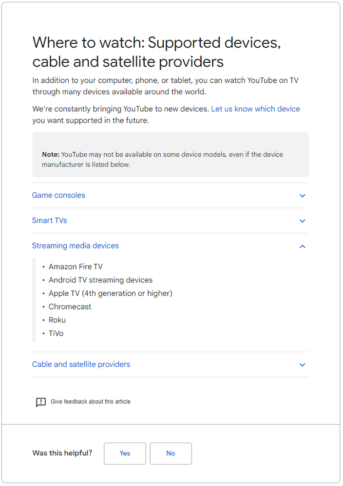

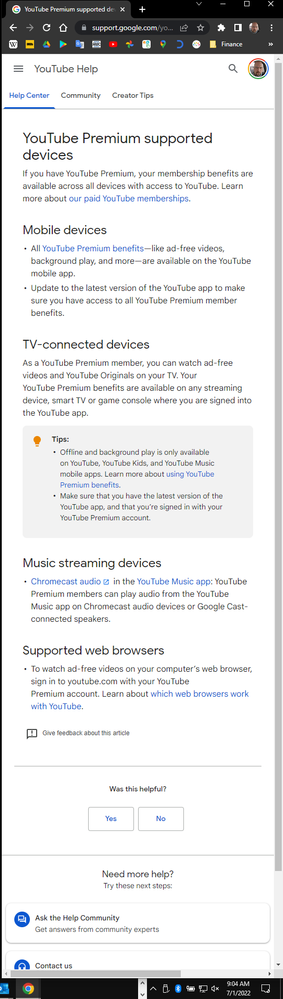

"...your membership benefits are available across all devices with access to YouTube.""...your membership benefits are available across all devices with access to YouTube."
"Oh, but YouTube isn't available on that model," right?
"Note: YouTube bay not be available on some device models, even if the device manufacturer is listed below.""Note: YouTube bay not be available on some device models, even if the device manufacturer is listed below."
BUT IT IS. YOU CAN WATCH AS A GUEST. YOU NEED TO CONNECT VIA EXTERNAL DEVICE WITH CASTING TO INITIATE IT BUT YOU CAN WATCH WITHOUT OPERATING THE EXTERNAL DEVICE AS LONG AS YOU ARE BOMBARDED WITH ADVERTISING AND UNWANTED VIDEOS, WHICH YOU CANNOT CIRCUMVENT WITH YOUR PAID SUBSCRIPTION.

I went to your Twitter team and they were just as apathetic. So I went back again today. This time, publicly, because the DM they insisted on went unanswered.
https://twitter.com/madebygoogle/status/1542885235708383232?s=21&t=rBYloxJNVn-G_u1yNTV1QQ
