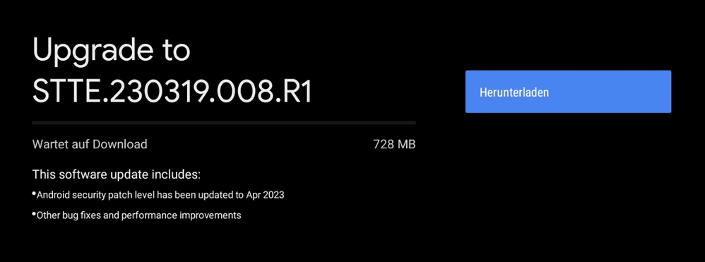

Try update STTE.230319.008.R1 from today and look if it fixes the issue:

waynoworld
Google just put out an update (230319.008.R1) that (has so far) addressed the issue.  Go to settings and manually update your CC.
This appears to have fixed it for me.
Actually 008 was applied before the problem occurred so I have no idea what fixed it. It simply started working the next day. I applied 008 on Wednesday afternoon and it wasn't working until yesterday.
GregM54
Go to settings and search through to system and get latest software update. This seems to have fixed the problem
