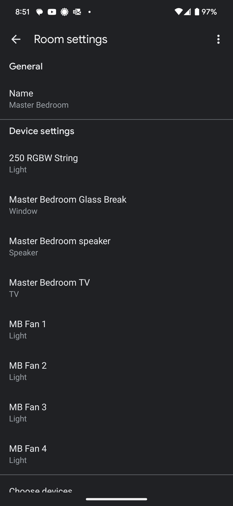

Hello I have had several rooms set up for a number of years now but after a recent update it looks like things got screwed up.  Specifically I have a master bedroom room and master bathroom room. I use to be able to tell my google home in the bedroom to "turn off the master bathroom lights" and things would work fine.  Now when I do this it turns off the master bedroom lights.  It seems as though it gets the word master and stops its recognition. Any idea how to fix this?  Please know I have several bathrooms with smart lights so I can't just make a generic "bathroom" room.

Hello Dan I have been programming my smart home for a number of years through the home assistant integration and have quite a bit of experience here.  In this case it's a nest mini 2nd gen. This issue came up about a week ago i think.  No recent changes. I have cycled power on the router and speakers and restated my z wave hub for the lights before making this post. It did not work.  It has something to do with the voice logic as I can call the lights individually and they work correctly.  When I call master bathroom it turns off the master bedroom lights.  If I move the master bathroom lights to another room (just bathroom for example) it works.  It seems as though the voice assistant logic gets to the word master and just functions on the master bedroom room. Removing master from either room brings functionality back.  I can't do this however since I have several bathrooms I need to designate the one as master bathroom. I do know this was an issue early on when the first Gen minis were still being sold (when I first started programming this home) but an update fixed this logic along the way.

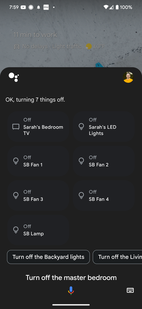

I have the same issues. It started yesterday. GH confuses master bathroom and master bedroom. I also have another bathroom which  I simply named "Bathroom". When I ask google to turn on/turn off the bathroom lights, it defaults to master bathroom. It worked flawlessly until yesterday.
I have no understanding of how Google Home and Assistant are getting this wrong. Master Bedroom commands are being executed for a completely different room, with consistency, and through automation commands as well as verbal commands. The rooms do not sound similar, and the command is recognized correctly as seen below. Last night I spent 2 hours, removing everyone, clearing the cache and data from 3 phones, then deleting the house and setting EVERYTHING including the Google Wi-Fi up from scratch. Re-imported all the 3rd party devices and still the same crap. When I go to a room within Google Home, and turn on and off lights through a tap, everything works as desired. When spoken or automated, it fails. This started about a week and a half ago. Was just living over it, but this has worked for years correctly, and no changes on my end.
