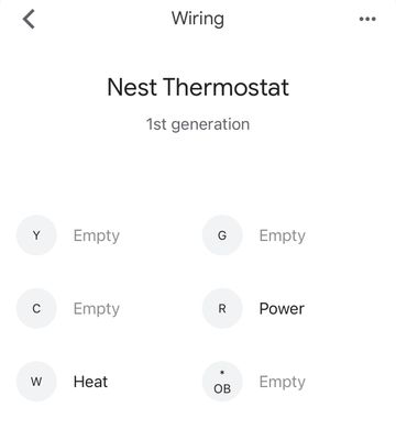

PS: If you still getting the error N261 (Undetected wires C-W(P)-R) make sure you go on the google app and update the wires:
settings > thermostat > wiring
