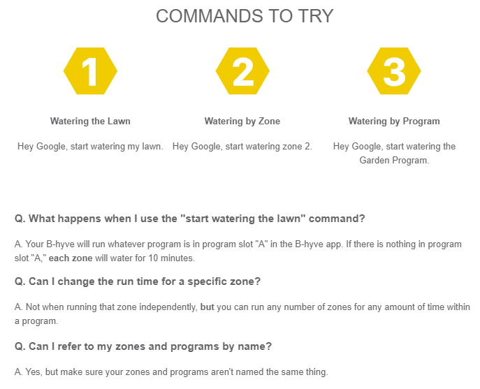

When trying to use voice commands I run into problems. Orbit claims that the following voice commands should work...
My zones are names "frontyard" and "backyard". Program A is labeled "Yard".
The command "Start Watering" Starts the program in slot A as expected. but google home returns an error message "can't load status" B-hyve
The command "Start Watering Zone 1" Returns an error message "sorry, it looks like that device hasn't been set up yet. You can do that in assistant settings"
The command "Start Watering Zone 2" starts a 10 minute program on zone 2 as expected and returns an error message, "can't load status, B-hyve" and reports status of "Alright, starting B-hyve in Zone 2"
The command, "start watering frontyard", Returns an error message "sorry, it looks like that device hasn't been set up yet. You can do that in assistant settings"
The command, "start watering backyard" starts a 10 minute program on zone 2 as expected and returns an error message, "can't load status, B-hyve" and reports status of "Alright, starting B-hyve in the backyard.
