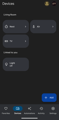

  • Check your Devices tab in Google Home and make sure the device is added to your room (you can follow this: Assign devices to a room if you don't know how to).
  • If you can see the device in the Home routine or Away routine now, it means the device is natively supported. (Go to Step 2a)
  • Otherwise, it's not natively supported. (Go to Step 2b)
For example, I already have a TV, an air conditioner, and a Nest Mini 2 in my room. Now, I created a new light in my 3rd party app and linked it to Google Home but haven't added it to my room yet (Btw, it's a fake light bulb because I don't have one).
When I try to create an Away routine, it also says "Choose at least one device to ..." even if I already have some devices in my room. Clearly, both the air conditioner and the TV are not supported by Home & Away routine currently.
Then, after adding the light to the room, the Away routine suddenly works!

Perfect thank you. I added my lights (yeelights) to rooms and these became available in the home / away routines. I'll check out the script editor for working with other devices.
