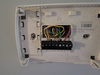

 Can I get help with wiring please?

Your thermostat is compatible with any of the Nest thermostats.
Wiring suggestion
White - Aux to W2 or W (set as aux heat)
Yellow - Y to Y1 or Y
Green - G to G
Orange - O to OB or */OB
Red - R to Rc or R
Blue C to C
THe "or" is for the Google Nest Thermostat wiring

Hi,
Yes I did thank you. I connected everything but for some reason it will not turn the AC on, only the fan.
Thanks for getting back to us. I'd love to know more about why your AC won't turn on.
Could you also share with us a photo of your Nest Thermostat's wiring? This is to see how you labeled it. Then, please check its power readouts on the Technical Info settings. Also, do you hear if your system kicked in when you called for cooling?
