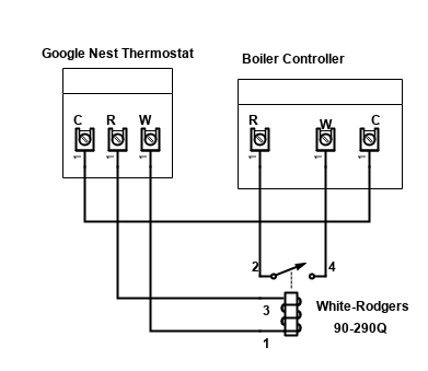

It sounds like the Nest doesn't have enough power to keep the solenoid energized.
Installing a relay can help solve this type of issue.
You might need something like this.

@Hosic, I hope you've got the answer you're looking for. Please let us know how it goes if you have a chance to install a relay between your Nest Thermostat and your system controller.
