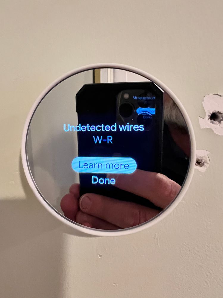

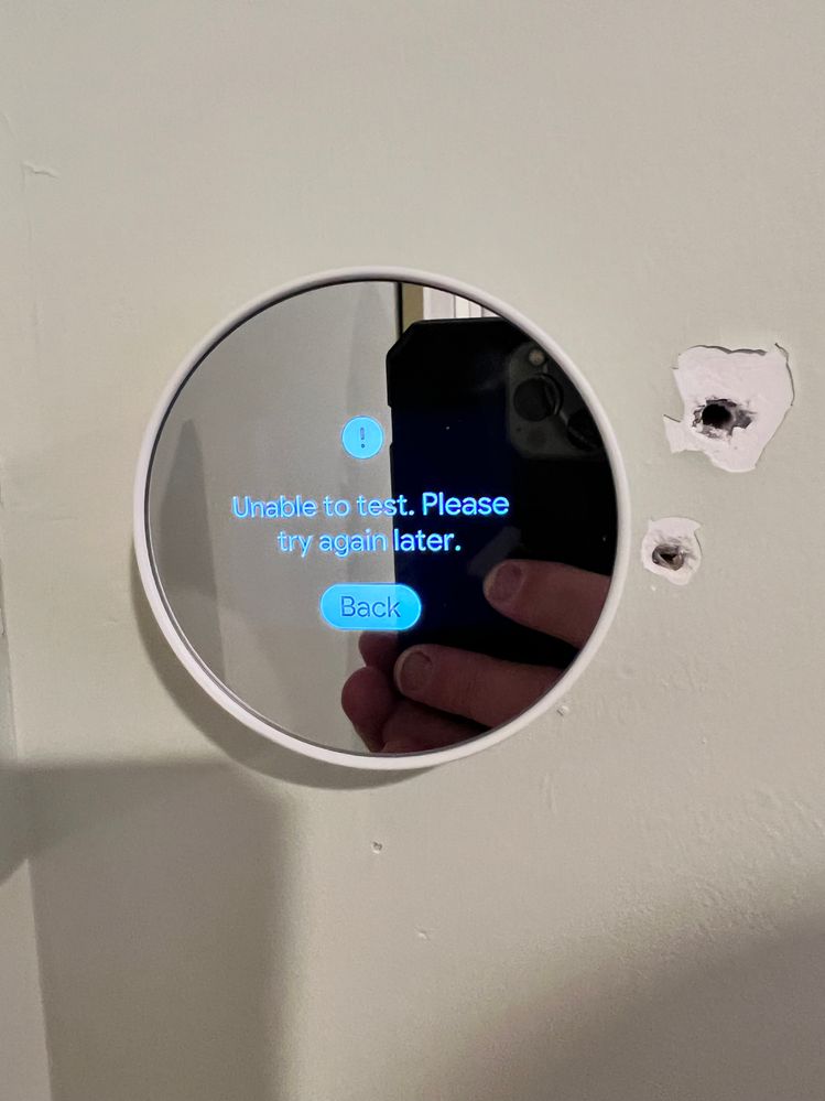

I went ahead and installed the Power Connector as per the directions. I still do not have the Nest powered. Could the Power Connector be bad? I attached some photos.
usernamenh
****UPDATE*****
I have solved the issue.
