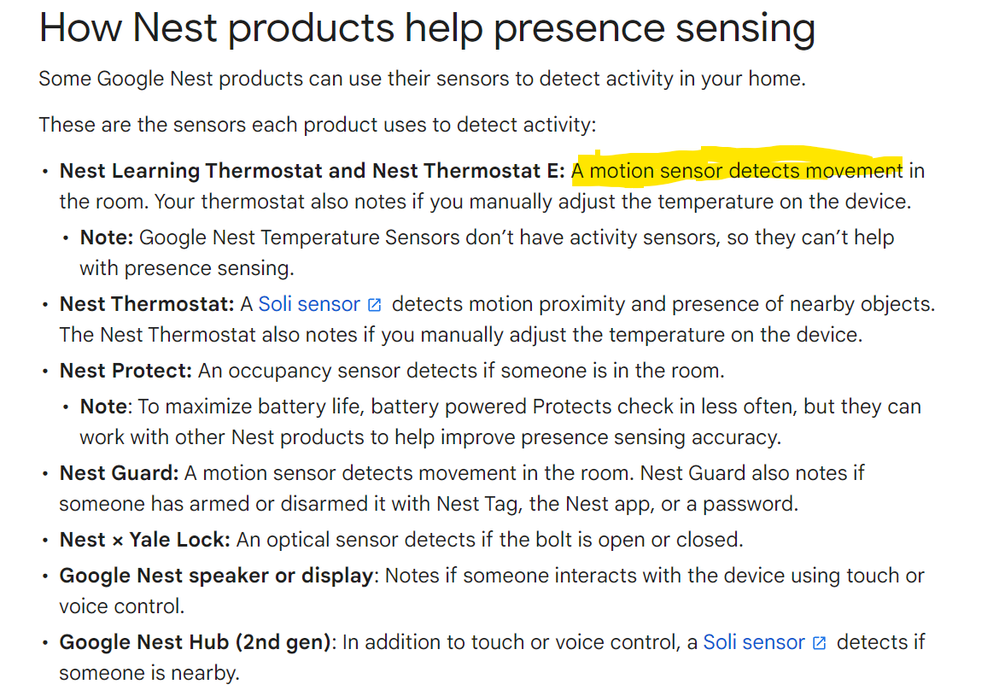

To confirm about the motion sensor, are you referring to the Nest Temperature Sensor linked to your thermostat or the built-in sensor on it? If this is caused by the thermostat sensor itself, it won't trigger the Home and Away Assist to switch to Away mode. A motion sensor only detects movement in the room.
Please take a look at this article to learn more about how it works, and let us know if you have more questions.

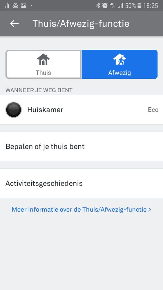

Hello Mark, thank you for your answer. Everyday i am trying to figure out how this function is designed to work and what am i missing. In the attachements something i found about automatically switching from home to away and something about the motion sensor.  To answer your question, no i have no extra sensors, the only thing is the thermostat. Also in the attachement, the settings in the nest app, when i am away (afwezig) i want it to switch to ECO, but in the last screenshot, you can see that i am away (afwezig) but no ECO. The strange thing is, yesterday evening i switched manually to home and 3 hours later it switched to away and ECO, but somewhere today it switched ECO off (someone probably walked into the room)but still says Away (afwezig)

I really hope i am doing something wrong and that is possible what i hoped for. I think i did my home work but somewhere i probably took a wrong turnauto away.pngMotion sensor.pngsetting away is eco.jpgaway but no eco.jpg

Hi, i am back again. At the moment i am in the house, we have guests, they put the heating to 20 degrees and then go sit outside. The thermostat still says away but the temperature stays set to 20 degrees, Whta is the point of making an away setting while only the icon changes?

Hello, i would like to give it another try, 4 weeks i am struggeling without any results, only high energy use. My NLT always shows AWAY but never switches to ECO, (setting Away = ECO) also when i walk to the thermostat and turn the ring it still says AWAY however i am standing in front of it. I desabled phone location to keep it simple and only want to use the motion sensor in te thermostat to decide wether i am home or not. I am trying really hard but i just don`t get it.
