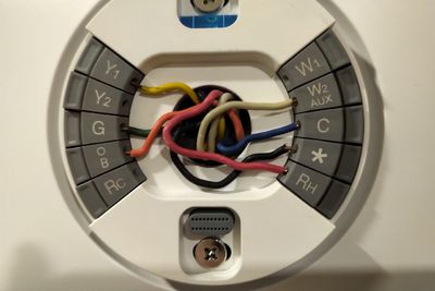

I'm sorry for the late reply. If the Heat Pump Balance doesn’t appear in the app or on your thermostat, you might have an incompatible system, or there could be a wiring issue that makes your thermostat think you have an incompatible system. Could you share with us a photo of your thermostat's wiring?

Heat Pump Balance is set to Max Comfort. My wiring has been checked by my HVAC company (I will try to find a way to send you a photo).
