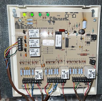

Do you happen to have a picture of the original thermostat's wiring that you can post?
Here are the previous setting

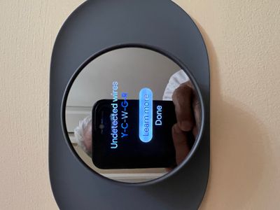

Thank you @Jake . I have gone through possiblly all articles on the Net! There is no problem in the wiring. C wire is there. I have now put a new Nest Thermostat this morning. So far, the fan is not kicking in randomly. I have made the safety temp = Off, Fan = Auto, Wire Y-C-W-G-R in good connected conditions. Gas > Forced Air, Early-on=Zero, Airwave=Yes, time-totemp=ready, Leag=ready. Comfort=67 heat, 75 Cool, Eco=56, 82, Sleep=62, 75.  Inside is 70, outside home is 56, set temp=67 . The fan did not run randomly during the day. I have to see it in the night. If this does not work, unfortunately, I will have to switch back to Honeywell!

You have a 3-zone system with zones 1 & 2 having a C wire, but zone 3 doesn't have a C wire.
Without a C wire on zone three, it will cause that thermostat to show the symptoms that you are talking about, but only on the zone 3 thermostat.
