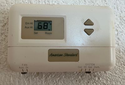

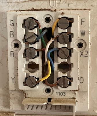

Hi again. Posted this photo before and now have a photo of the front of the old thermostat. All I know is that this runs a heat pump. Don’t know where on the outside unit Id need to take more pix of. Any chance anyone has a clue how to transfer this to a Nest thermostat?

Your current thermostat is compatible with the Nest 3rd Gen Learning Thermostat only.
Try this wiring
Green - G to G
Dark Blue - B to C
Red - R to Rc
Yellow - F to not used, tape off
White - W to W2 (set as AUX Heat)
Blue - X2 to *(set as Emergency heat)
Brown - O to OB
Thanks. What about that lighter yellow on Y?
Oops, my bad
Yellow - Y to Y1
