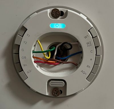

SXA
Sorry couldn’t post a photo at first
SXA
The system is heating and cooling
SXA
 the brown wire is completely sheathed and not attached to anything
AndersC
Hi @SXA,
Thank you for the photos. From my side, the wiring appears to be correctly connected to your Nest Thermostat.
