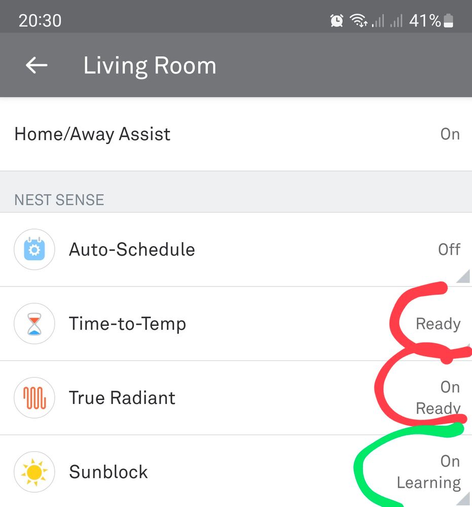

I have true radiant on, this means that if I set 20 degree at 8am then the thermostat will start pre-heating in order to have 20 degree at 8am but... will it also keep that temp for the rest of the day?
Said another way: if I want to make sure that temp in my house is 20 degree from 8am till 9pm, how should I set the scheduling?
2.
How can I put Time To Temp and True Radiant back to learning mode? I have reset totally the thermostat (first I removed thermostat from app then reset thermostat) but while now Sunblock is in learning mode, Time To Temp and True Radiant are on ready: I would like thermostat to re-learn.
Thx

Thanks for reaching out. If you don't have a schedule aside from the target temperature of 20 degrees, then your Nest Thermostat will maintain that temperature until you change it.
Resetting your Nest Thermostat should delete all the data that your Nest thermostat have learned. Just to clarify, did you reset all of its settings?
Edward
I did reset al settings, and cleared data of the app, yet true radiant is still in teady mode, not learning.

Thanks for the response. We'd like to know more about this. Please fill out this form so we could investigate further.
