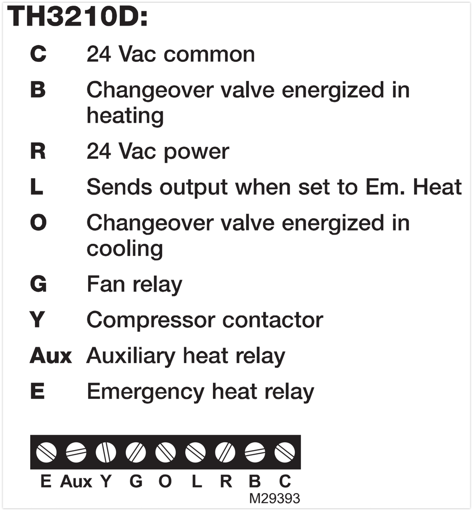

I have replaced the old Honeywell TH3210D with Nest v3. I suspect I'm wired it incorrectly because the heat pump does not produce heat.
On the old thermostat blue wire connected to the Y terminal. As I read in the Honeywell manual, Y is a compressor (cooling), so I connected it to the Y1 terminal on Nest.
Then, I connected the orange wire from the O terminal of Honeywell to the "OB" terminal on Nest, as I understand that it is a heat signaling cable. But I'm quite unsure now.
Could you please point out my mistake please? 🙂
Attaching the old and new wiring as well as the Honeywell's specs.
h_manual.pngNestNest
photo_2023-02-17 19.49.53.jpegOld HoneywellOld Honeywell

Try this wiring,
Black - E to * (set as emergency heat)
White - AUX to W2 (set as aux heat)
Blue - Y to Y1
Green - G to G
Orange - O to OB
Red - R to Rc
White/Black to C
bushev
Sure, I added C wire, but unfortunately, it does not work...
Post a picture of the terminal block on the control board in the furnace/air handler.
