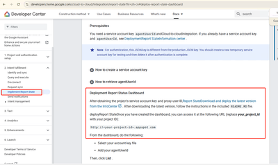

I have been running testsuite and the status has not changed. The review has not been approved
It seems that this step has not been completed, resulting in the testing status remaining unchanged
I downloaded the source code and followed it,
cd src/main/ngapp
npm install
npm run build
# Built files will be added in src/main/webapp
I don't know what the purpose of editing this is,but it also generates errors during compilation

Thank you for sharing. The Report State Dashboard was deprecated some time ago. For device status updates, please use the Homegraph Viewer instead.
