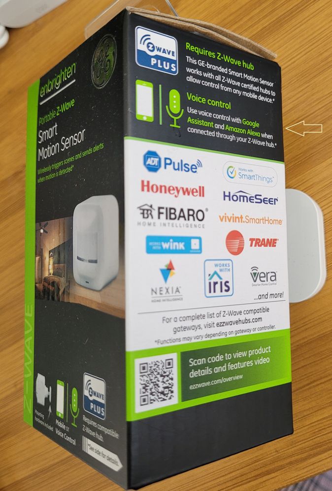

Hello Google Home app team and engineers:
I recently added 2 (two) of  GE/Jasco zwave+ 34193 / ZW6302 portable smart motion sensors into my Samsung SmartThings hub. Everything is working fine there.
When I link my SmartThings to Google Home app/Google Assistant, however, these 2 sensors are no where to be found. I also tried Unlink and Reconnect SmartThings with Google Home app/Google Assistant, alas no luck.
On the Amazon.com website where I purchased them (link: https://www.amazon.com/GE-Enbrighten-Activation-SmartThings-34193/dp/B01KQDIU52), it says GE/Jasco zwave+ 34193 / ZW6302 supports SmartThings and Google Assistant (Voice Control). The Google Assistant integration is also displayed/written on the GE/Jasco zwave+ 34193 / ZW6302 box (see attached photo).
I have contacted Samsung SmartHub technical team as well as GE/Jasco technical team, and they both informed me that I should contact the Google Home app / Google Assistant team and engineers to question the missing motion sensor integration with Google Home / Google Assistant.
Could you please look into this integration and let me know if this can be resolved?
Truly appreciate the help! Thank you!
kiltguy2112
This is a zwave device that Google does not know how to use, so it gets stripped out when other devices are brought over from smartthings.  Do yourself a big favor, and have Smartthings be your actual controller. Only use Google as a voice trigger. All your routines/scenes should be performed by Smartthings, not Google.
