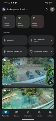

 Hi @kelanfromgoogle and @Wrenloch
I just read the link you provided above and have screenshotted below.
I may be being stupid but I cannot see the functions described in the Google Home app
It says open the app and then a mysterious "start a playback session"
How do I do that? As far as I can see there is no way to start a playback session from any screen in the Home app, other than creating a cast mirror of device audio on my phone.
As far as I know voice commands are the only way to play and these would play via whichever app is configured..this in turn would be the app you would then expect to be able to control the volume from..i.e launch in Spotify..control from Spotify or by voice (.i.e "reduce volume by 10%")
I wouldn't expect separate and distinct media controls to come up.
I attach a screenshot of three screens in the Home app..please can you direct me to which one fulfils the instructions show in the instructions in the link you provided below in #2 #3 and #4
The Devices Screen?
 The Favourite Screen?
 The Device Cast Screen?
1000040420.pngPlease let us know.
I think when most of us want speaker groups to work we either have a default group set as playback for each listening device (i.e my kitchen hub default playback group is Kitchen Group) and I would ask Kitchen Hub to play XYZ (Radio, Spotify YT Music, BBV Sounds) and it would play on the default group OR I would speak a specific device group name IF I did not want it to play on the default group. I.e play xyz ON Lounge Group or "play THIS on Lounge Group INSTEAD" if I was moving room.
During this my mobile device should not need to be anywhere near me...as it is voice commands..
