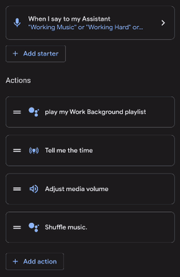

I have a "work background" playlist on my subscription-paid YouTube Music account with 285 randomly liked songs in absolutely no particular order. Work Background
A routine starts playing it each day at 8am, and shuffles the tracks, but it never makes it all the way to lunchtime. It just stops playing anything saved on my playlist, and picks something I've never heard before (or worse, something I have heard enough times to absolutely dislike!).
I am not sure why this is happening for me either. After about 3 hours of playing familiar songs, I eventually notice the strange music choices and tell my speaker to start the routine "working music" again, so it returns to my desired playlist (which it shuffles after starting to play that very first track on the list.).
