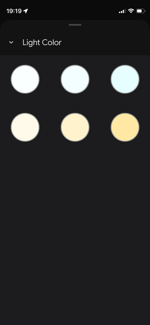

Same issue here with a different set of Matter bulbs:
AiDot OREiN Matter Smart Light Bulb, RGBTW, model OS0100811267
Worked fine for the past two years, and then suddenly this week under "Color" when clicked into the light's settings in the Google Home mobile app (on iOS) the only options listed are different temperatures of White, instead of the full RGBW range of options that used to be displayed.

betweentehlines
Hi Beula,
I have tried the troubleshooting steps as suggested but the issue still persists. Only showing shades of White for color options (and if try to change light to colors such as 'blue' or 'red' or 'green' via voice commands to Google Nest speaker the speaker mistakenly responds that the device is offline). Here are the steps I have tried:
1. Uninstalled and reinstalled the Google Home iOS app.
2. Unlinked the smart bulb from the Google Home app.
2.1. Hard-reset the smart bulb.
5. Re-linked the smart bulb to the Google Home app.
6. Contacted bulb manufacturer (AiDot) and received confirmation that there has been no firmware update shipped for these bulbs since November of 2025.
The following steps are not applicable, since like @makataktak I bought Matter bulbs to be able to connect directly to Google Home without using or linking a third-party app:
3. Uninstall and reinstall the third-party app associated with the bulb.
4. Remove one of the bulbs from the third-party app, then set it up again.
Given no recent changes from the manufacturer of my smart bulbs, it seems like it's something on the Google Home app side of things since the loss of functionality aligns closely with the timeline of when Google Home v4.14.53 shipped for iOS... Potentially is a bug with how Google Home is identifying the features/capabilities of Matter smart bulb devices?

betweentehlines
Seems to be fixed, at least on iOS, in the Google Home app v4.15.55
Given nothing else changed in the device firmwares, network setup, etc. that does appear to validate that this was a bug in the Google Home app w/ respect to RGBW Matter bulbs. Glad it's fixed for now!
