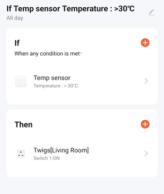

I have managed to use a mixture of Tuya scenes that turn on an LED lamp when the temperature reaches a certain level.
Then I use a Google home automation that activates when that device is on and runs other automations.
It's the long way of doing something that SHOULD work as advertised! I will also be contacting Sonos about why this device doesn't support the Google assistant as it is advertised to.
