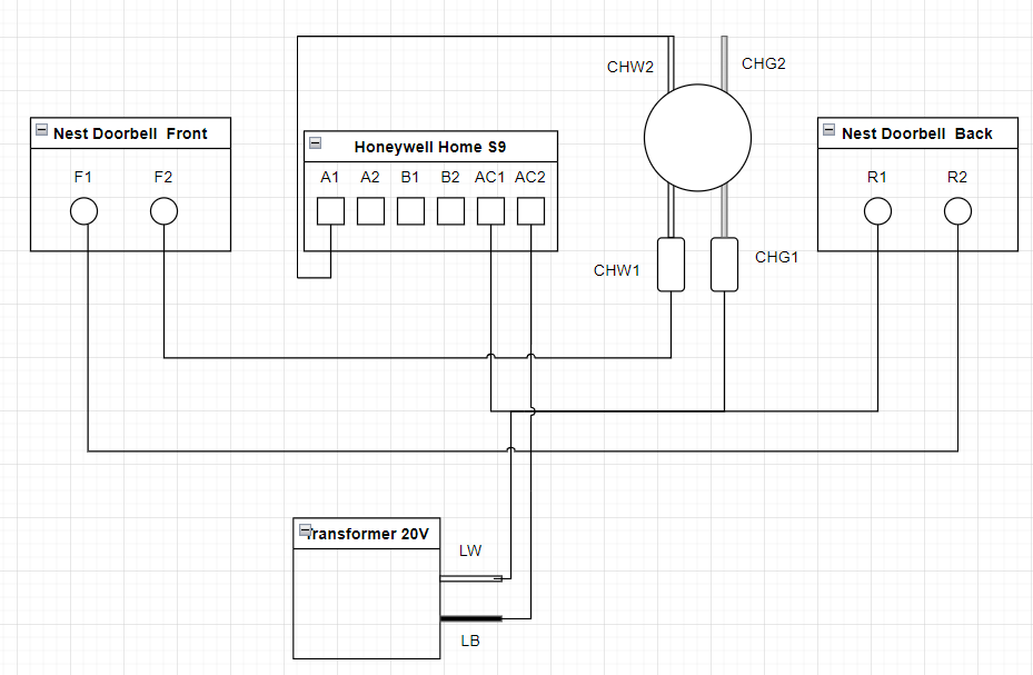

I had mechanical chime with an older Nest Doorbell (without Chime thingie), and it was working fine.
Problems occured when I tried to add a second, newer, Doorbell that came with the chime thingie.
Because it wouldn't work correctly (and I hated that chime), I replaced that chime with an Honeywell electronic one.
I found wiring diagrams for one doorbell with Honeywell, but none with 2 doorbells, especially one with only one chime thingie.
So could a nice person out there tell me how I should wire my two Nest Doorbells with the Honeywell Home chime, so that both can ring it?
Below is how I currently have them connected:
  • Both doorbell cams are working
  • Back Doorbell isn't connected to chime
  • Front Doorbell should be connected, but
  • Chime is not ringing when I push the front doorbell
Keep in mind that I don't have a second chime thingie, and my front doorbell was working fine without it with my previous chime.
Thank you very much
JSPetit
Update, my front Doorbell is working with the chime with the diagram I posted. Maybe my chime was not plugged all the way earlier.
Back door is not connected to chime, but since I configured it with the NEST app , it rings on my cell, so it's a decent workaround, especially for a back doorbell nobody uses.
I'll still use the form, because it'd be nice if it worked.
