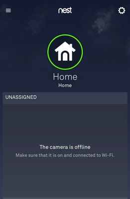

It’s on the nest IOS app. I followed the set up instructions it found the camera and got as far as putting in the WiFi password. It then just kicked me out of the app like it had crashed.  Here is a photo of what it looked like when I opened the app again

There seems to be no way of removing the camera as the settings are just blank as above

Okay, so you have a 1st gen Google Nest Hello Doorbell. (We have three.) They haven't been sold by Google Nest for maybe a year or more, so is your doorbell used and/or previously installed?
Can you select the Settings icon in the upper right corner, then select "Home info", then select "Wi-Fi help", and then select your doorbell? If so, you might be able to update your doorbell's Wi-Fi settings.

Another option is this: It looks like your Nest Hello Doorbell is the only Google Nest device in your Google Nest "home/structure", which you've named "home". If that's the case, and if you are logging onto the Google Nest app with the "Sign in with Nest" option, then you could try deleting your Google Nest "home/structure" named "home" from the Google Nest app, using these instructions:
https://support.google.com/googlenest/answer/9293015?hl=en&co=GENIE.Platform%3DiOS&sjid=327231142729...
(We now log on with the "Sign in with Google" option, so I don't know exactly how the removal is done in the Google Nest app.)
If removing the "home" works, you could recreate your Google Nest "home/structure" and then try to install your doorbell.

The following worked.
Another option is this: It looks like your Nest Hello Doorbell is the only Google Nest device in your Google Nest "home/structure", which you've named "home". If that's the case, and if you are logging onto the Google Nest app with the "Sign in with Nest" option, then you could try deleting your Google Nest "home/structure" named "home" from the Google Nest app, using these instructions”
It meant I could add the camera again and it installed fine this time
