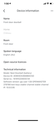

Im having trouble setting up my Google Nest Doorbell (Battery)
I manage to go through the Setup, the Doorbell's camera is streaming to the iPhone during the setup stage but once setup is complete the Google Home App says that the device is unmounted (see attach). I have unmounted and remounted the Doorbell several times, I have performed a hard reset the Doorbell twice, and I've used an Android Smart Phone to test if it's an issue with the iOS, and I unfortunately have the same issue.
Does anyone have any thoughts or suggestions (I have also provided device information attached below so I am open to any suggestions.
Kind Regards,
Device information (does any of this information help?)
The Screen that comes up when the Doorbell is selected

"Some of the metal brackets must be made with a slight imperfection that prevents it from hitting the button on the back of the doorbell properly. To be clear, i had the doorbell completely locked into place correctly with the first mounting bracket and it didn't work. Did the same exact thing with the 2nd bracket and it worked perfectly. And this must be why other people said the only fix they could figure out was to buy a new doorbell. The new doorbell came with a mounting bracket that didn't have the imperfection."
(https://www.googlenestcommunity.com/t5/Cameras-and-Doorbells/Why-my-100-charged-mounted-google-doorb...)
Do you know know if it is possible to order a replacement mount? I'm happy to pay for shipping or any additional fees.

The New Doorbell that was the given to me fixed the issue and the Google nest Doorbell is operating as normal.
