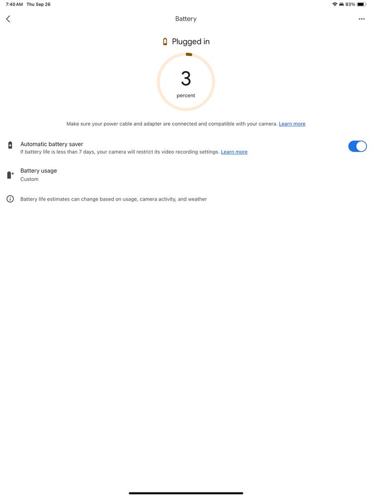

However, again and again the camera battery status - in Google home app on iOS - changes from the infinity symbol to a battery level of 6% and then 3% and finally empty. Sometimes the device comes back online and shows the infinite battery status again.

Hello - like I said, the device is hardwired and power is always on. Just last night it showed up again in Google Home as functioning and connected to power. Now the battery is empty again and the device is offline.

It's odd that you have a "Make sure your power cable and adapter are connected and compatible with your camera" message on your Battery settings page. We don't get that message on our battery camera, which has been plugged in since Sept. 2021.
