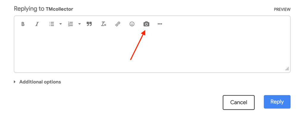

The forum DOES allow posting photos. You have to be logged into the forum (by clicking on the blue profile in the upper right corner) BEFORE clicking on REPLY. Then click on the camera icon.
