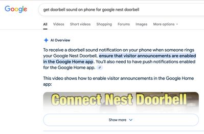

"Visitor announcements" send an oral announcement and a doorbell sound to your Nest Hubs and Nest Minis, if you have any.  We use it with our 1st gen doorbells and our Nest Hubs.  I notice that the TEXT on Google Search's "AI Overview" on this subject is simply wrong; this is Google Search's incorrect result:

According to Google Nest's documentation, "Visitor announcements" get sent to Google Nest speakers and displays, NOT to phones:
https://support.google.com/googlenest/answer/7672451
