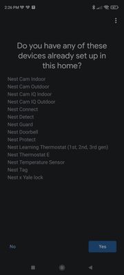

I am having a very frustrating time setting up two outdoor nest cameras. On Google home, I try to add the device and when I get to the part 'do you have any other of the following nest devices set up in this home' and I click no because the camera is the first device in that home, I get 'something went wrong. Please try again'.

 screenshots added to show more detail of where in the setup I am getting stuck.

Which camera are you trying to set up, the newer Google Nest Camera (Battery) in the Google Home app or the older Google Nest Outdoor Camera in the Google Nest app? Are you by any chance reinstalling these cameras in a "home" that is currently empty, but previously had cameras or other Google Nest devices installed? If so, maybe Google Nest "remembers" that previous "home" and you could try answering "Yes" to see what happens.

No, there have been no other devices set up at this home before. I set up the home to add these cameras to. I've tried answering yes to see what happens and it just says the person who previously set up devices should migrate there account and to send them instructions. So, it doesn't apply and doesn't let me proceed.
Now, I am going to try a previous version of the Home app and see if that works. And if that fails, try with an iPhone.
I got it working. The previous versions of the home app on Android did not work either. So I used an iOs phone and they were added no problem.
There seems to be a bug with the android app. I've let the support team know so hopefully it is rectified in the next update.
