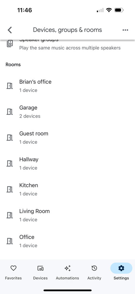

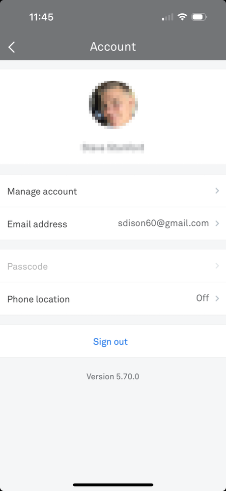

SteveRyder
When you say should appear automatically, I'm not sure this is happening. See from the 3 screen prints, I'm using the same gmail account in Nest and Home app. Also see the devices listed in Home app, I have several devices but I don't see the doorbell.Nest appNest appHome appHome appHome app devicesHome app devices
@SteveRyder
In the Google Nest app, is the name of your Google Nest "home/structure" (which displays on the initial screen under the word "Home" and alternates with your local temperature, and which contains your doorbell) the same as the name in the Google Home app of your Google Nest "home/structure" (which displays in the upper left corner of the newly updated Google Home app and which contains your other Google Nest devices).
The name of your Google Nest "home/structure" also displays at the top of the home.nest.com and home.google.com websites, and should be the same on both sites.
By the way, you should probably delete your screen captures from your post, since they show your email address.
That was the answer. I checked the home/structure on both apps and got it working. Thanks for sticking with me!
