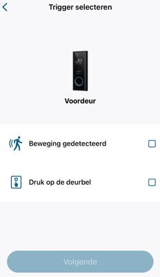

In the Eufy app there is a possibility to allow for trigger doorbell press (second trigger in de second screenshot below), but offcourse I cannot select my Hue devices to do something there:
