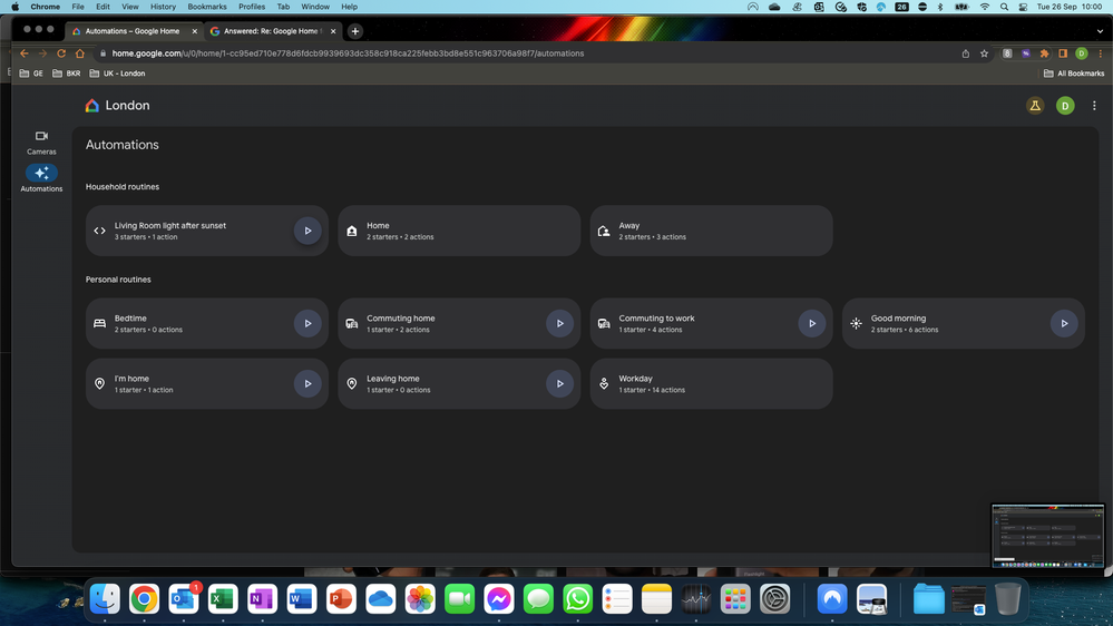

a few days ago I wrote a simple automation via Google Home for Web. The purpose is for a smart bulb in the living room to turn on at sunset if I'm at home (or if the camera detect a person or if the tv is on).
I validated the automation successfully but, as I close the Script Editor with the "Activate" on, the automation is not active. I then try to turn on the relative automation in the Automation page in Google Home for Web by clicking on the "Play" button, the message "Starting the routine" pops up, the "Play" button becomes a "Tick" to show that is activated, but it goes back to "Play" button after a few seconds.
Finally, the automation I wrote is not showing anywhere in the Google Home app on my phone.
Could you please help me out? I don't understand what's the issue.
Thank you so much!

09-26-2023 02:09 AM
Hello sipriyadarshi,
see below the metadata for the routine and attached the various screenshots. Couldn't find a way to upload a video recording of the process in this thread though.
One last note: if I'm removing the "home.state.homepresence" starter (due to the warning), the routing presents the same issues (not starting at all).
Thanks for the help!
Diego
Warning message when saving routine
Detailed message on the warning (I've added two other starters to have some redundancies)
After I close the script editor (and leaving the "Activate" on), it brings me back to the Automations spash page, but the routine is not ON
Activation message when I click on the "Play" button of the routine
After a few moments and with no other message, it deactivates itself
