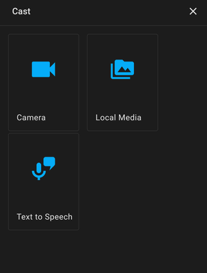

When setting up Home Assistant you can have it recognize Google devices.
I would create an automation using Home assistant..
https://www.home-assistant.io/docs/automation/
And one of the actions I would use would be to cast to any of my devices either a spoken message or an alert sound I have stored as a media file
Have a look at some of the demos available on the Home assistant website.
https://demo.home-assistant.io/#/lovelace/0
