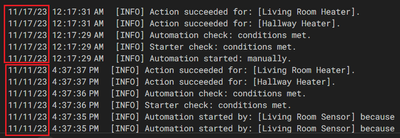

The execution log for my scripted automations appears to halt abruptly after several executions. The log starts again if I deactivate and activate routines. Because of this, it’s not possible for me to know if the scripts are running or not. As you can see, there's a gap in log entries from the 11th to the 17th of November, resuming only after I deactivate and activate the routine.

Any idea why this is happening? Thanks!
What kind of sensors do you use? I am using Tapo T100 motion sensors and starters don't seem to work because nothing happens when movement is detected.
Hello, I'm using Phillips Hue motion sensors. The problem I previously mentioned resolved itself a few days after my post. Since then, I've occasionally noticed delays in automation execution.
