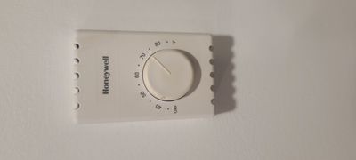

I currently have a Honeywell thermostat and would like to replace it with a Nest thermostat.

Electronic Baseboard heating only.
01-24-2023 11:43 AM
I appreciate your efforts in sharing the photos. However, it doesn't show how the wires are being labeled, such as by showing what terminals they're connected to. If possible, could you at least share with us a photo of your system's control board showing where the wires from your thermostat are connected? In this way, we can see what the use and why they are being tied.

Hi Allen1013,
Thanks for sharing the photo. It appears that you have a high-voltage system with 120V or 240V and wire nuts. The L terminals are for the line or supply, and the T terminals are for loading. Basically, L is power in, and T is power out. In some cases, it's possible that your system can be made Nest Thermostat-compatible. But you'll need to contact a local pro and have them install a step-down transformer to 20- to 30-volts.
