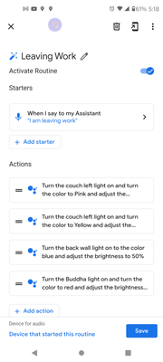

here are pictures of an automation that does not work. Everytime a start it it says something like : actually this functionality is not working with lampe 70. Even if I have the option directly in the light bulb setting like shown in the last image. My bulbs are Geeni and globe suite bulbs which are tuya bulb I think.  @Juni

Hi Deboxta,
Thanks for reaching out and for the screenshot. I'll merge this to the original thread since we are already working on that one. This thread will be locked automatically once merged in the main one.
