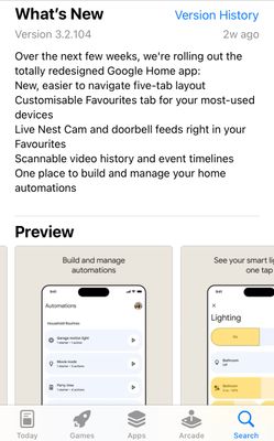

That’s interesting, I just checked on the App Store to make sure I was using the latest version and noticed the following preview referring to upcoming updates and showing motion activated starter:

I just noticed that the same link is on the broad home.google,com site at Introducing the redesigned Google Home | Google Home.  I'm on the public preview, version is 3.2.1.7, but nothing yet.  Maybe it means it's coming soon, but it's really poor that they're plugging something which doesn't exist.
