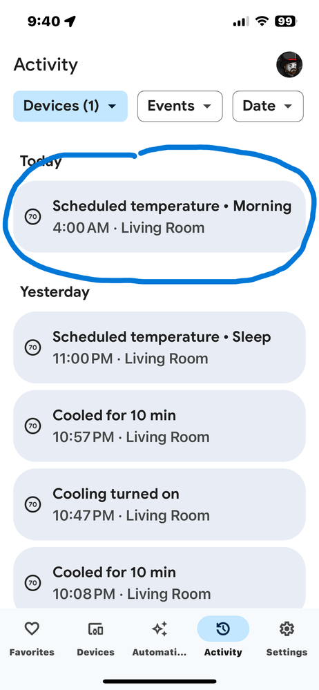

I have a AprilAire 100 dehumidifier controlled by my 4th Gen Google Stat.  My target humidity is 50%, but the stat never reaches 50%  (only 53%).  The stat/dehumidifier only runs for 10mins because the default setting with the stat (something I don't have access to) stops so that the coils don't freeze up.   This is an issue. I need the stat to run for 15 or 20 mins.
bryanhudson
In these pictures cooling/dehumidifier stopped at 4am and its 9:41am.  This happens in the morning...
