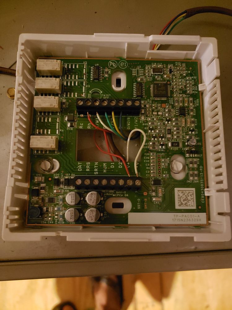

I have a new Nest Learning Thermostat (T3018US).  My current thermostat is a Carrier TP-PAC01-A.  It only has 2 wires coming to it from the wall (V+Red, VgBlack).  It is not compatible as is with the Nest which needs 6 wires (Y,G,Rc,W,C,Rh).  Is there any way I can make my current thermostat work with the new Nest.  I included a picture of my current thermostat opened up.

Carrier.Thermo. Wiring.Converter.jpgHi,
Thanks for the quick reply.  I figured the 2 wires coming to the thermostat from the Carrier furnace / blower in the attic was a Carrier digital signal (like ethernet as you say).  Unfortunately the attic is 2 stories hire than the thermostat and I don't want to pull the 6+ wire HVAC cable down since I'd have to walk on the beams which is a bit dangerous at that high a level.  I don't have plywood put down all over the attic.  What I was wondering is in there is a converter I can put near the thermostat that I can convert the Carrier 2 wires back to the 5-6 wires that the Nest Thermostat needs.  The Carrier Edge thermostat I have is already programmable.  What I really like about the Nest or Echobee is that you can put the remote temperature sensors in other rooms to control the temperature.  I included a picture of the Carrier board where the red and white wires are the ones that run downstairs to my thermostat.
