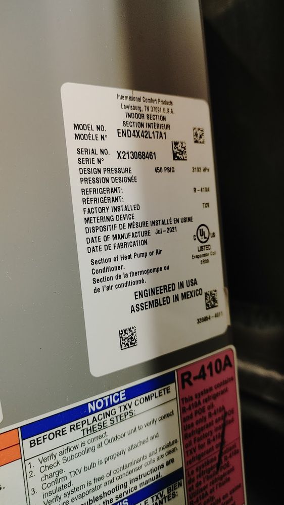

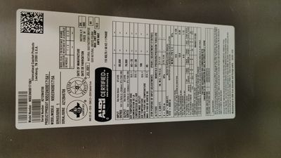

Here is an image of the furnace details. I also checked the fuse in the furnace and it was ok. 20231212_223302.jpg
