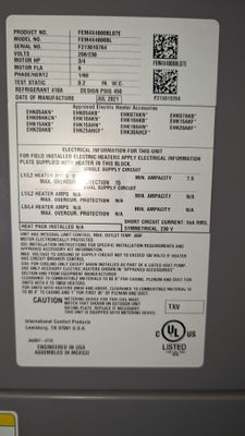

Can you post a picture of the connections in the furnace/air handler?
Also, can you post a picture of its manufacture and model number?
Most of the time the installers will leave the installation manual with the unit. Post a picture of its front cover if you can.
Jaybird82
 no manual was left
