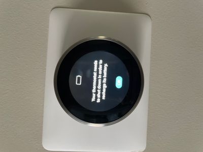

I my thermostat upstairs is saying it must shut down to recharge battery and won’t display temperature. I tried to reset it. Took it off and unscrewed it and didn’t see any ASA battery to replace. Help! Where do you recharge the batteries

3rd generation. And see picture. Then I hook up to USB plug to charge it I get 2nd picture to put it back on base. I do and it recycles back up and then I check back and it’s dead again. Do I have to replace the whole thermostat?

when I connect to the USB it immediately says to put back on base. But this time I am charging it for 2 hours as it was blinking Red and the screen was black. Now why would the battery die? I did have my system turned off due to the weather being nice to open windows but I am not sure when the problem started. I just don’t want to have to buy a new thermostat because it’s not charging properly. I have 2 thermostats and the one downstairs works fine.

It’s still not working. The display is still showing needs to shut down to recharge battery. I charged it for 3 hours yesterday. I don’t know how to check wiring but everything looks fine. Am I going to have to replace the thermostat because it doesn’t seem to charge? Ugh!

 After charging for 3 hours and putting the stat back on the base it will show a G and look like it’s cycling then give this on display. I don’t know what strength the USB port is but as soon as I plug it in to the stat it will show the G and look like it’s cycling and then give me a display that it needs to go back on the base. I will look into seeing if I have any other USB plugs to charge it
