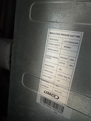

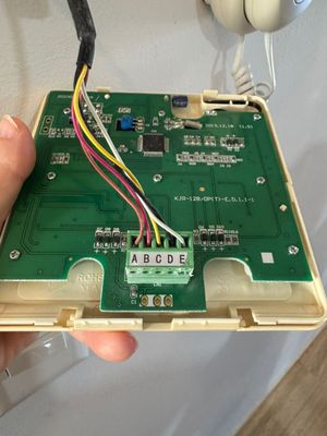

Want to see the way to install the nest learning thermostat to a Lennox system
PHOTO-2024-12-17-11-36-17.jpgPHOTO-2024-12-17-11-35-52.jpgPHOTO-2024-12-17-09-25-49.jpgPHOTO-2024-12-17-09-26-03.jpgPHOTO-2024-12-17-09-26-19.jpg

Your current thermostat uses a propitary interface that is not compatible with any of the Nest thermostats.
Look in the furnace/air handler and take a picture of the control PCB and the terminal blocks.
I have looked for but can not find the Lennox Thermostat that you have pictured. Is there a model number or such on it?
