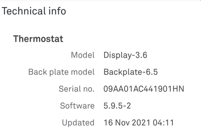

01-16-2022 12:16 AM
My Tech info says Model 3.4, Software 5.9.5-2, Updated Never and i've had it about 18 months. So it doesnt look to me that it can be the Nov update as I've always been running on this version....

01-17-2022 12:55 PM
Something else that's doing my head in having to use both Nest and Home. There are options for using your mobile phones location in each of the 2 apps but only one can be enabled. If enabled in Google Home then it gets turned off in Nest and seemingly vice versa. I also thought the same was true for Home/Away assist but can't find it in GH now
Google Home
NestSo no idea if that's causing a conflict somehow. Now I can't find Home/Away assist option in the GH app,
01-18-2022 06:27 AM
Perhaps you have tired this but have you actually gone into Routines and checked to see if this routine was automatically created by the the Thermostat(s)? If not, I believe you can create a routine yourself to some extent.
