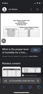

Third item is really a wish list.  Since it’s a little computer, can’t a small routine be coded to make this device adjust humidity level automatically based on outdoor temperature?   It’s connected to internet so it knows outdoor temp all the time.  That would be really cool and make it something user can enable or disable if they want. See chart. (Prevents window condensation and damaging frost forming in winter months).  This is cool but not important item for the short term.
