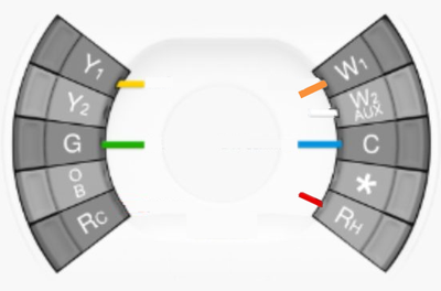

When I connect the NEST thermostat I follow the instructions and set as follows:
  • Blue Wire - C
  • Red Wire - Rh
  • Orange Wire - W1
  • Yellow Wire - Y1
  • Green Wire - G
  • White Wire - W2
The heat works great on both heat 1 and heat 2 settings. The A/C never gets cold. It blows and acts like it is working, but it just never blows cold.

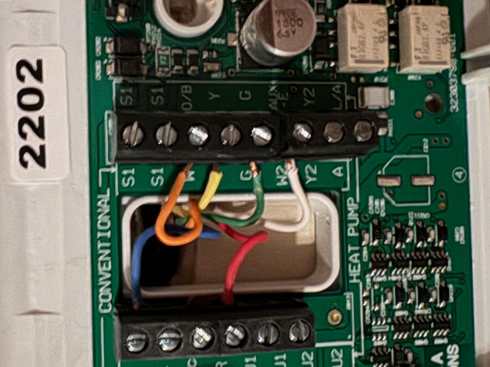

I believe it is a fuel pump system. This is how it was previously setup:
This is how I wired the Nest Thermostat:

Hi, @NestedBear,
Thank you so much for your response and for all the details provided. Based on the pictures, it seems you have a heat pump system.
Here's how to connect the wires to your Nest Learning thermostat (3rd generation):
